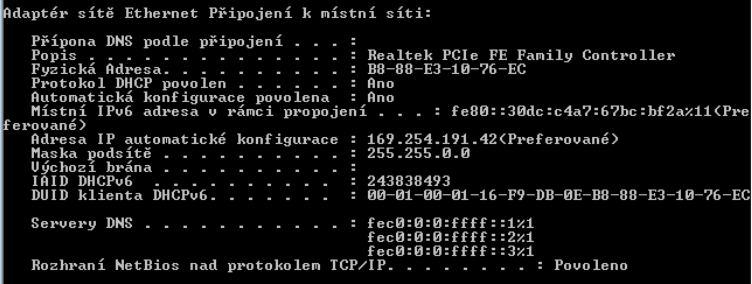

Adresa IP 169.254.191.42 a maska 255.255.0.0

Tak dhcp nejde. Bud je v riti firmware uplne, alebo je ina default ip a default dhcp disabled. (.. j…

[http://pc.poradna.net/file/view/28807-ipconfig-png ]
