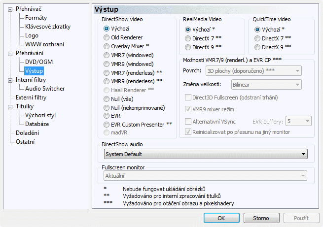

Jak to teda máš nastavené? Oni to tam dokonce píšou: [http://pc.poradna.net/file/view/2961-mpc-png]
karel 25.02.2010 22:56
přesně takhle, změnil jsem v direct show video: z Overlay Mixer* na Výchozí....a něktré jdou, někter…

Q: The 'Save Image' and 'Save Thumbnails' functions in Media Player Classic give an error
A:
Media Player Classic gives error: GetCurrentImage failed, hr = 8000ffff
The solution is to change the output renderer. The renderer in Media Player Classic is set to Overlay Mixer by default, since that is the most compatible renderer. However, saving images or taking screenshots is not possible with Overlay.
You can change the renderer in MPC Options -> Playback -> Output -> DirectShow Video.
