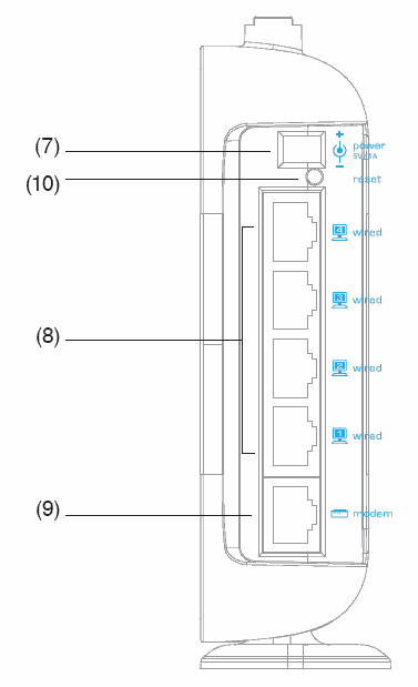

10. Reset Button ...
a. Resetting the Router
Push and release the “Reset” button. The lights on the Router will momentarily flash. The “Power” light will begin to blink. When the “Power” light becomes solid again, the reset is complete.
b. Restoring the Factory Defaults
Press and hold the “Reset” button for at least 10 seconds, then release it. The lights on the Router will momentarily flash. The “Power” light will begin to blink. When the “Power” light becomes solid again, the restore is complete.
tlačítko 10 viz zadní strana routeru:
[http://pc.poradna.net/file/view/3653-belkin-f5d723  4-back-png]
ještě popis: žlutý konektor 9 vede k modemu od providera, šedé konektory 8 vedou k tvým pc.
