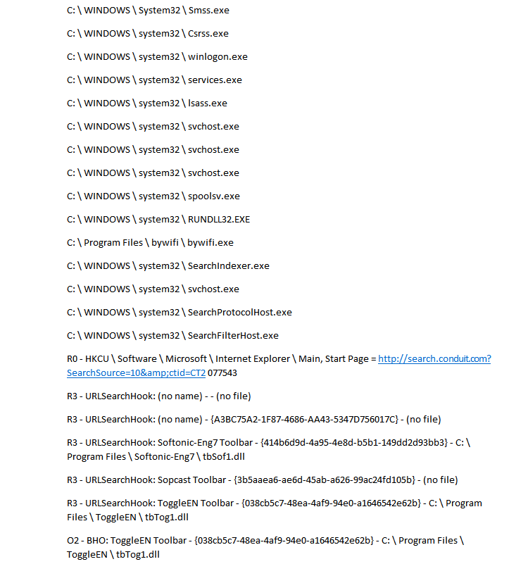

prohlídni to s hijackthis a pošli log sem.Víš jak?
Jo díky,takže hijackthis:
Logfile of Trend Micro HijackThis v2.0.4
Scan saved at 8:56:26, on 30.11.2010
Platform: Windows XP SP3 (WinNT 5.01.2600)
MSIE: Internet Explorer v8.00 (8.00.6001.18702)
Boot mode: Normal
Running processes:

R0 - HKCU\Software\Microsoft\Internet Explorer\Main,Start Page = http://search.conduit.com?SearchSource=10&ctid=CT2 077543
R1 - HKLM\Software\Microsoft\Internet Explorer\Main,Default_Page_URL = fwlink
R1 - HKLM\Software\Microsoft\Internet Explorer\Main,Default_Search_URL = fwlink
R1 - HKLM\Software\Microsoft\Internet Explorer\Main,Search Page = fwlink
R0 - HKLM\Software\Microsoft\Internet Explorer\Main,Start Page = fwlink
R0 - HKCU\Software\Microsoft\Internet Explorer\Main,Local Page =
R0 - HKLM\Software\Microsoft\Internet Explorer\Main,Local Page =
R1 - HKCU\Software\Microsoft\Windows\CurrentVersion\Int ernet Settings,AutoConfigURL = proxy.pac
R1 - HKCU\Software\Microsoft\Windows\CurrentVersion\Int ernet Settings,ProxyOverride = local
R3 - URLSearchHook: (no name) - - (no file)
R3 - URLSearchHook: (no name) - {A3BC75A2-1F87-4686-AA43-5347D756017C} - (no file)
R3 - URLSearchHook: Softonic-Eng7 Toolbar - {414b6d9d-4a95-4e8d-b5b1-149dd2d93bb3} - C:\Program Files\Softonic-Eng7\tbSof1.dll
R3 - URLSearchHook: Sopcast Toolbar - {3b5aaea6-ae6d-45ab-a626-99ac24fd105b} - (no file)
R3 - URLSearchHook: ToggleEN Toolbar - {038cb5c7-48ea-4af9-94e0-a1646542e62b} - C:\Program Files\ToggleEN\tbTog1.dll

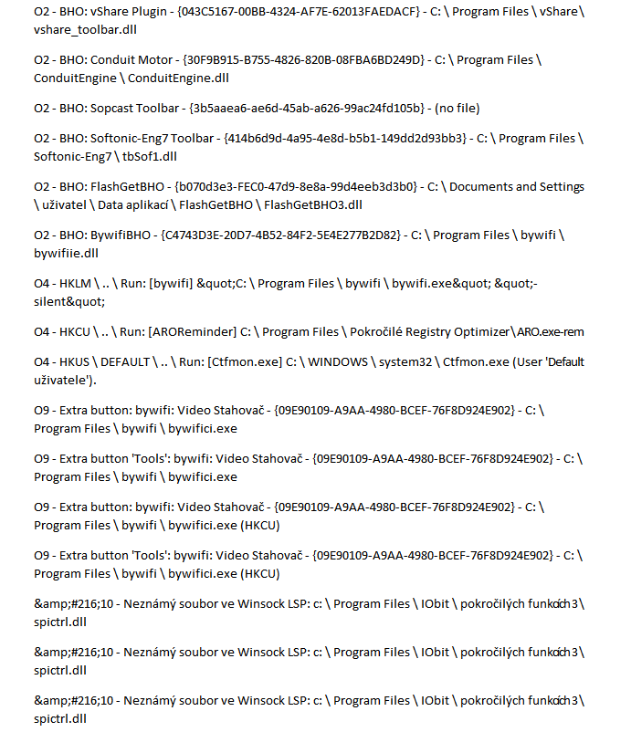

O2 - BHO: ToggleEN Toolbar - {038cb5c7-48ea-4af9-94e0-a1646542e62b} - C:\Program Files\ToggleEN\tbTog1.dll
O2 - BHO: vShare Plugin - {043C5167-00BB-4324-AF7E-62013FAEDACF} - C:\Program Files\vShare\vshare_toolbar.dll
O2 - BHO: AcroIEHelperStub - {18DF081C-E8AD-4283-A596-FA578C2EBDC3} - C:\Program Files\Common Files\Adobe\Acrobat\ActiveX\AcroIEHelperShim.dll
O2 - BHO: RealPlayer Download and Record Plugin for Internet Explorer - {3049C3E9-B461-4BC5-8870-4C09146192CA} - C:\Documents and Settings\All Users\Application Data\Real\RealPlayer\BrowserRecordPlugin\IE\rpbrow serrecordplugin.dll
O2 - BHO: Conduit Engine - {30F9B915-B755-4826-820B-08FBA6BD249D} - C:\Program Files\ConduitEngine\ConduitEngine.dll
O2 - BHO: Sopcast Toolbar - {3b5aaea6-ae6d-45ab-a626-99ac24fd105b} - (no file)
O2 - BHO: Softonic-Eng7 Toolbar - {414b6d9d-4a95-4e8d-b5b1-149dd2d93bb3} - C:\Program Files\Softonic-Eng7\tbSof1.dll
O2 - BHO: Spybot-S&D IE Protection - {53707962-6F74-2D53-2644-206D7942484F} - C:\PROGRA~1\SPYBOT~1\SDHelper.dll
O2 - BHO: Google Toolbar Helper - {AA58ED58-01DD-4d91-8333-CF10577473F7} - C:\Program Files\Google\Google Toolbar\GoogleToolbar_32.dll
O2 - BHO: Google Toolbar Notifier BHO - {AF69DE43-7D58-4638-B6FA-CE66B5AD205D} - C:\Program Files\Google\GoogleToolbarNotifier\5.6.5805.1910\s wg.dll
O2 - BHO: FlashGetBHO - {b070d3e3-fec0-47d9-8e8a-99d4eeb3d3b0} - C:\Documents and Settings\user\Application Data\FlashGetBHO\FlashGetBHO3.dll
O2 - BHO: BywifiBHO - {C4743D3E-20D7-4B52-84F2-5E4E277B2D82} - C:\Program Files\Bywifi\bywifiie.dll
O2 - BHO: Java(tm) Plug-In 2 SSV Helper - {DBC80044-A445-435b-BC74-9C25C1C588A9} - C:\Program Files\Java\jre6\bin\jp2ssv.dll
O2 - BHO: JQSIEStartDetectorImpl - {E7E6F031-17CE-4C07-BC86-EABFE594F69C} - C:\Program Files\Java\jre6\lib\deploy\jqs\ie\jqs_plugin.dll

O4 - HKLM\..\Run: [bywifi] "C:\Program Files\Bywifi\bywifi.exe" "-silent"

O4 - HKCU\..\Run: [AROReminder] C:\Program Files\Advanced Registry Optimizer\ARO.exe -rem

O9 - Extra button: Bywifi: Video Stahovač - {09E90109-A9AA-4980-BCEF-76F8D924E902} - C:\Program Files\Bywifi\bywifici.exe
O9 - Extra 'Tools' menuitem: Bywifi: Video Stahovač - {09E90109-A9AA-4980-BCEF-76F8D924E902} - C:\Program Files\Bywifi\bywifici.exe
O9 - Extra button: (no name) - {DFB852A3-47F8-48C4-A200-58CAB36FD2A2} - C:\PROGRA~1\SPYBOT~1\SDHelper.dll
O9 - Extra 'Tools' menuitem: Spybot - Search & Destroy Configuration - {DFB852A3-47F8-48C4-A200-58CAB36FD2A2} - C:\PROGRA~1\SPYBOT~1\SDHelper.dll
O9 - Extra button: (no name) - {e2e2dd38-d088-4134-82b7-f2ba38496583} - C:\WINDOWS\Network Diagnostic\xpnetdiag.exe
O9 - Extra 'Tools' menuitem: @xpsp3res.dll,-20001 - {e2e2dd38-d088-4134-82b7-f2ba38496583} - C:\WINDOWS\Network Diagnostic\xpnetdiag.exe
O9 - Extra button: Messenger - {FB5F1910-F110-11d2-BB9E-00C04F795683} - C:\Program Files\Messenger\msmsgs.exe
O9 - Extra 'Tools' menuitem: Windows Messenger - {FB5F1910-F110-11d2-BB9E-00C04F795683} - C:\Program Files\Messenger\msmsgs.exe
O9 - Extra button: Bywifi: Video Stahovač - {09E90109-A9AA-4980-BCEF-76F8D924E902} - C:\Program Files\Bywifi\bywifici.exe (HKCU)
O9 - Extra 'Tools' menuitem: Bywifi: Video Stahovač - {09E90109-A9AA-4980-BCEF-76F8D924E902} - C:\Program Files\Bywifi\bywifici.exe (HKCU)
O10 - Unknown file in Winsock LSP: c:\program files\iobit\advanced systemcare 3\spictrl.dll

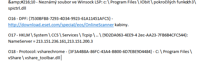

O16 - DPF: {7530BFB8-7293-4D34-9923-61A11451AFC5} - http://download.eset.com/special/eos/OnlineScanner .cab
O17 - HKLM\System\CCS\Services\Tcpip\..\{9D2DA063-4EE9-4 2EC-AA23-7FB6B4CFC544}: NameServer = 213.151.236.161,213.151.200.3
O18 - Protocol: vsharechrome - {3F3A4B8A-86FC-43A4-BB00-6D7EBE9D4484} - C:\Program Files\vShare\vshare_toolbar.dll
