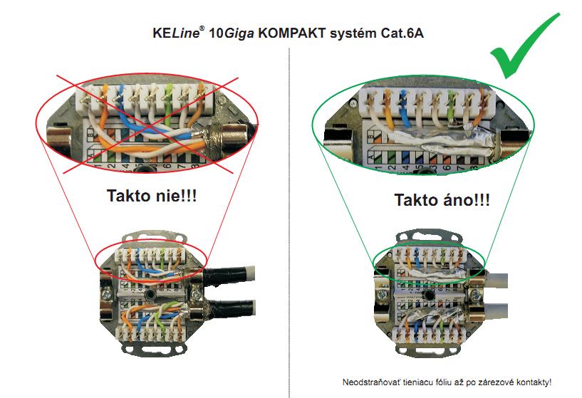

Hlavne pozor na toto:
![[6775-cat6-jpg]](/file/view/6775-cat6-jpg)
