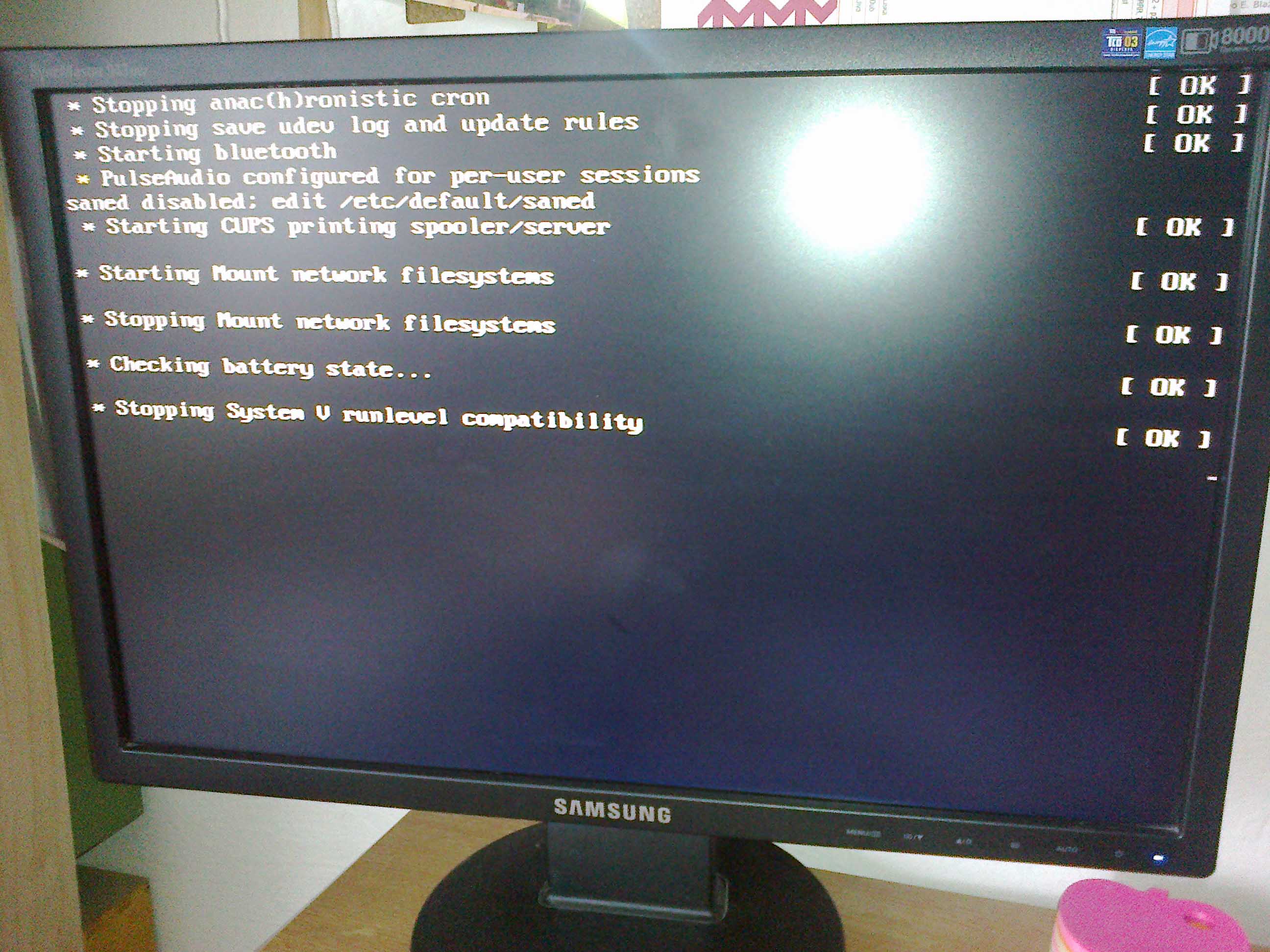

Přidat otázku mezi oblíbenéZasílat nové odpovědi e-mailem Opět jsem umořil linux, co dělám blbě?
Ubuntu, aktuální, po výběru systému, kdy tam mám dualboot s win 7, vyberu tedy Ubuntu. Pak jen problikne načítání Ubuntu ... a vyskočí obrazovka viz foto:
[http://pc.poradna.net/file/view/9247-22042012020a-  jpg]
Změny neproběhly od minulého spuštění veškeré žádné, max jsem nainstaloval Krusader..
Co to má znamenat, dá se s tím něco dělat?

My problem is solved by installing: lightdm-gtk-greeter It seems that version 11.10 replace gdm by…

I suppose it's just what you see when X11 fails to start during the boot procedure. I just had the s…
lightdm-gtk-greeter
It seems that version 11.10 replace gdm by lightdm start manager and because the version upgrade didn't install the greeter package, the new lightdm didn't work.
Four hours lost due to this silly issue
This worked perfectly for me. Thanks.
Jon
worked for me too,
go to Ubuntu Software Centre > search ''lightdm'' > more info > add-ons > install "unity-greeter".
Problem solved
Thanks
Z prvního odkaz v googlu
I suppose it's just what you see when X11 fails to start during the boot procedure. I just had the similar issue but it had nothing to do with my chipset or else graphics card. I went to the terminal with Ctrl-Alt-F1 and made some attempts with the startx . I did have a cluster of fglrx issues from my nVidia graphics card, but under that was an error concerning being unable to write a keyboard configuration file.so as I found from some sources , it came to my notice that I was out of disk space. Freeing up some resolved the issue completely in my case. I think the nVidia issues were just since it was scanning every PCI port for devices.
I also have some more information as some guys have issues regarding lightdm and lightdm-gtk-theme. And all is sorted out as installing gdm package will assist .in addition, You need to run dpkg-reconfigure gdm. This will completely resolve your issue of lightdm.
Ubuntu má "recovery mode"
http://1.bp.blogspot.com/-DAoIzD2ZBjM/TtZHYBNRP1I/ AAAAAAAAFCs/nVg15g46Zno/grub2_picture.png
