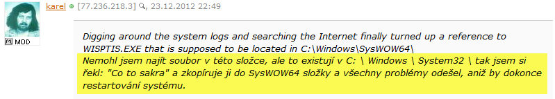

Digging around the system logs and searching the Internet finally turned up a reference to WISPTIS.E…
karel 23.12.2012 22:49

Digging around the system logs and searching the Internet finally turned up a reference to WISPTIS.EXE that is supposed to be located in C:\Windows\SysWOW64\
I could not find the file in that folder, but it did exist in C:\Windows\System32\ so I figured "What the hell" and copied it into the SysWOW64 folder and all problems went away, without even restarting the system.
Zkontrolovat, jestli tam ten soubor trůní, případně ho zkopírovat. Třeba ale tohle nezabere, není znám ani použitý OS. Názvy souborů a složek jsou stejné v češtině i angličtině.
