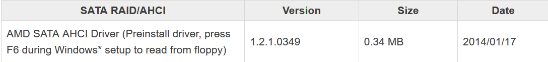

Vetsinou je jiz nainstalovany auto, ale mas ovladac na AHCI? Instaloval jsi ovladac pro <chipset> ?
[img=/file/view/24024-ahci-png]http://pc.poradna.net/file/view/24024-ahci-png[/img]
<Ovladace> : http://www.gigabyte.com/products/product-page.aspx ?pid=4717#dl
