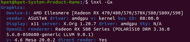

I GPU od AMD jsou rozeznany a zavedeny bez potreby dalsi instalace ci uprav. "Direct_render" je v default aktivovany (tusim ze to plati jiz od Mesa 19.*):
[89660-gpu-poradna-png]
Popripade staci v /etc/X11/xorg.conf upresnit :
Section "Device"
    Identifier "AMDGPU"
    Driver "amdgpu"
    Option "AccelMethod" "glamor"
    Option "DRI" "3"
EndSection

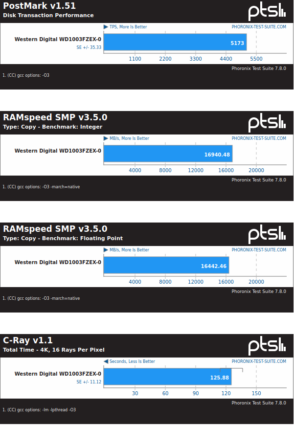

Benchmark CPU Ryzen kernel 5.4 vs 5.6 :
Kernel 5.4
(Na test jsem zvolil Generic_Kernel a SW pro benchmark pod Ubuntu jsem pouzil https://www.phoronix-test-suite.com/?k=downloads)
- Post Mark : 5173
- SMP integer: 16940
- SMP Floating : 16442
- C-RAY (méne = lépe): 126
[89659-ryzen-kernel-5-4-png]

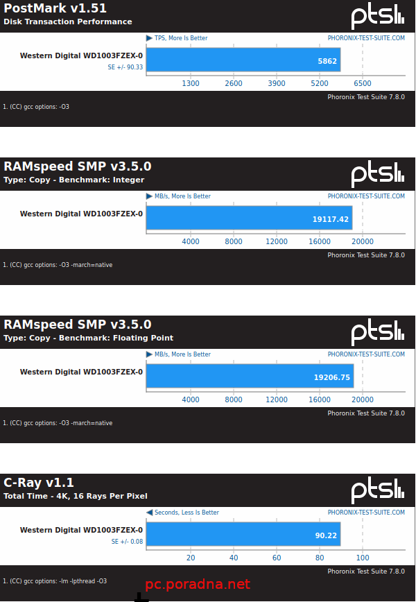

Kernel 5.6 :
- Post Mark : 5862
- SMP integer: 19117
- SMP Floating : 19206
- C-RAY (méne = lépe): 90
[89658-ryzen-kernel5-6-png]
