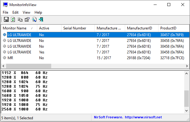

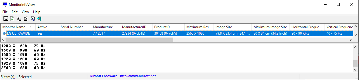

Zkus se podivat na EDID : https://www.nirsoft.net/utils/monitor_info_view.html jestli ten adapter je…
