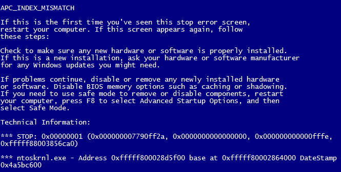

V XP je to horší. Po spuštění po skončení obrazovky s housenkou skočí modrá smrt a restart
A problem has been detected and Windows has been shut down to prevent damage
to your computer.
The problem seems to be caused by the following file: ntoskrnl.exe
MEMORY_MANAGEMENT
If this is the first time you've seen this stop error screen,
restart your computer. If this screen appears again, follow
these steps:
Check to make sure any new hardware or software is properly installed.
If this is a new installation, ask your hardware or software manufacturer
for any Windows updates you might need.
If problems continue, disable or remove any newly installed hardware
or software. Disable BIOS memory options such as caching or shadowing.
If you need to use safe mode to remove or disable components, restart
your computer, press F8 to select Advanced Startup Options, and then
select Safe Mode.
Technical Information:
*** STOP: 0x0000001a (0x0004128b, 0x0005d201, 0x00000000, 0xc0883000)
*** ntoskrnl.exe - Address 0x804f9f43 base at 0x804d7000 DateStamp 0x4b7a9cac

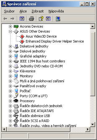

Vyřešeno. Ve správci zařízení byly ještě dvě bezkonflikní položky ASUS (motherboard i GK 8800 jsou… poslední
