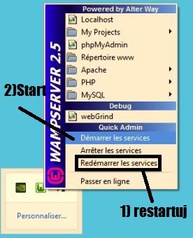

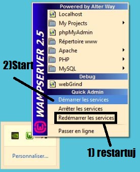

- Tak ten server RESTARTUJ a nasledovne SPUST (ikonka musi byt zelena, ale to zrejme vis)
[img=/file/view/19179-pc-poradna-jpg]http://pc.poradna.net/file/view/19179-pc-poradna-j pg[/img]
