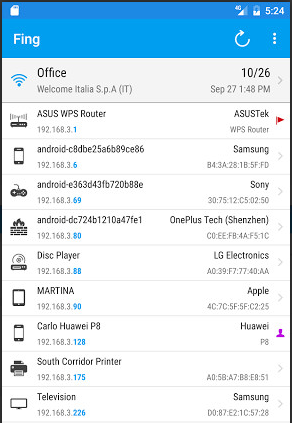

Jo, FING by fungovat mohl.
https://play.google.com/store/apps/details?id=com.overlook.android.fing
[89131-fingwifiscan-png]
