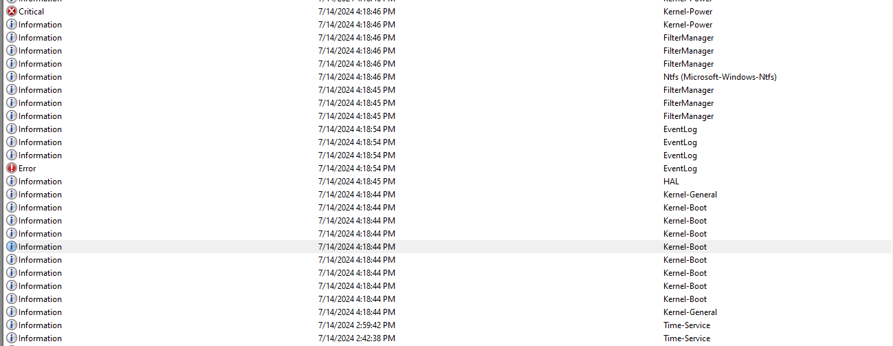

Zdarec, bol som teraz pred chvíľou dajme tomu 20 až 30 minút na posteli a pozeral som videá na TT, YT. Komp som nechal normálne bežať (nedal som ho ani do režimu spánku) a z ničoho nič sa sám od seba vypol. Tak som popozeral event viewer a tam som našiel nejaký critical no moc sa z toho vyčítať nedalo keďže sa tam písalo The system has rebooted without cleanly shutting down first. This error could be caused if the system stopped responding, crashed, or lost power unexpectedly..

- Ako som spomínal vyššie, opäť mi to vyhodilo Critical do Event Vieweru. Avšak ten hlási len to, že sa komp nečakane vypol.

Ale aby ste mali pokoj na duši tak tu sú tie ďalšie event logy (Informations): - The operating syst… nový
sakulmore 14.07.2024 17:30
sakulmore
- The operating system started at system time ‎2024‎-‎07‎-‎14T14:18:44.500000000Z.
- Virtualization-based security (policies: 0) is disabled.
- There are 0x1 boot options on this system.
- The bootmgr spent 0 ms waiting for user input.
- The last shutdown's success status was false. The last boot's success status was true.
- EFI time zone bias: 2047. Daylight flags: 0. Firmware time: ‎2024‎-‎07‎-‎14T16:18:43.000000000Z.
- The boot menu policy was 0x1.
- The boot type was 0x0.
- The firmware reported boot metrics.
- The leap second configuration has been updated.
Reason: Leap second data initialized from registry during boot
Leap seconds enabled: true
New leap second count: 0
Old leap second count: 0
- The iommu fault reporting has been initialized.
- (Error) The previous system shutdown at 15:05:40 on ‎14. ‎7. ‎2024 was unexpected.
- Microsoft (R) Windows (R) 10.00. 22631  Multiprocessor Free.
- The Event log service was started.
- The system uptime is 9 seconds.
- File System Filter 'FileInfo' (10.0, ‎2079‎-‎02‎-‎27T00:03:00.000000000Z) has successfully loaded and registered with Filter Manager.
- File System Filter 'Wof' (10.0, ‎2086‎-‎08‎-‎04T13:20:16.000000000Z) has successfully loaded and registered with Filter Manager.
- File System Filter 'WdFilter' (10.0, ‎2055‎-‎04‎-‎20T22:48:29.000000000Z) has successfully loaded and registered with Filter Manager.
- Volume C: (\Device\HarddiskVolume3) is healthy.  No action is needed.
- File System Filter 'FileCrypt' (10.0, ‎1983‎-‎08‎-‎19T04:58:35.000000000Z) has successfully loaded and registered with Filter Manager.
- File System Filter 'UCPD' (10.0, ‎2103‎-‎03‎-‎14T02:38:32.000000000Z) has successfully loaded and registered with Filter Manager.
-  File System Filter 'npsvctrig' (10.0, ‎1979‎-‎12‎-‎19T18:12:41.000000000Z) has successfully loaded and registered with Filter Manager.
- ACPI thermal zone \_TZ.TZ00 has been enumerated.
_PSV = 0K
_TC1 = 0
_TC2 = 0
_TSP = 0ms
_AC0 = 357K
_AC1 = 328K
_AC2 = 323K
_AC3 = 318K
_AC4 = 313K
_AC5 = 0K
_AC6 = 0K
_AC7 = 0K
_AC8 = 0K
_AC9 = 0K
_CRT = 378K
_HOT = 0K
minimum throttle = 0
_CR3 = 0K
- (Critical) The system has rebooted without cleanly shutting down first. This error could be caused if the system stopped responding, crashed, or lost power unexpectedly.
